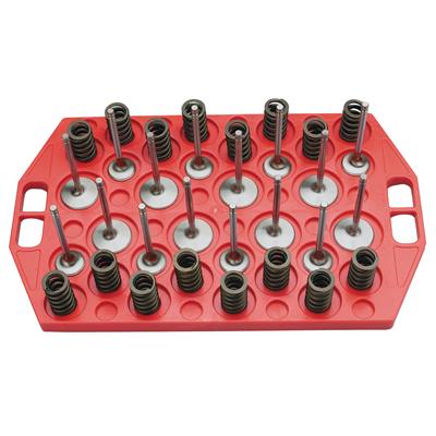

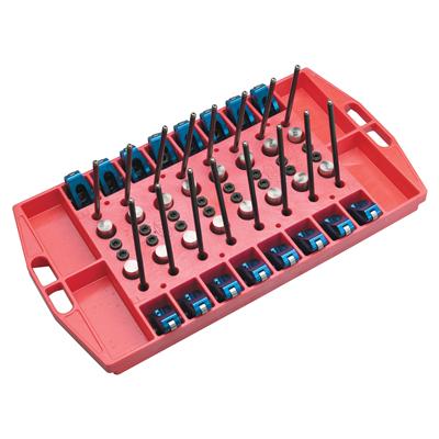

I used to use the case that the two liter bottles are delivered to the market in. They are usually piled up behind the market next to the milk crates. Don't steal one, if you look you will find them floating around like milk crates.
I used to use egg crates to keep rockers and pushrods organized.
I sometimes get generic ziplock bags for a couple bucks for like 200, and use a sharpie to label each bag to keep things organized when doing stuff.
I haven't rebuilt an engine in a few years but I remember summit used to sell a molded piece of plastic that was just for organizing the parts for a rebuild.
Chris
[UPDATE]. Here it is: http://www.summitracing.com/parts/sum-900013/overview/
http://www.summitracing.com/parts/sum-csum2600
This one is a little cheaper from summit: http://www.summitracing.com/parts/crn-99015-1
