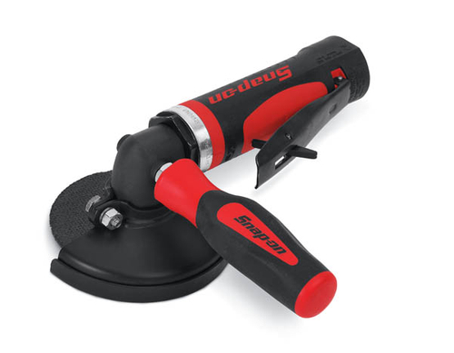

I have no idea what they were threaded for, you and I paid for them, but evidently uncle sam doesn't remember what they were for either, so he's getting rid of them.

I found out what they thread onto:
rlitman
Oct 18, 2010
24,777
Long Island
No. These are file handles, and the part number confirms they were from a file set. The threaded handle screws itself onto the file tang. They're actually pretty awesome handles.
The auction's part number is SGHF616B.
An HF-616 is a normal hard file handle (I've got one of these, and the OEM for the threaded insert appears to be Pferd).
The G means it was a government purchase with no warranty (not that these are known to fail).
I'm not sure if the S or the B make it the Instinct style.
I see an SGHF617A on eBay that has a soft handle.

Regardless of what color they are , the instinct Handle with the black is the soft grip version , the hard version is grey
