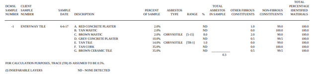

Just inside my front door, I've got a 50 sf area to cover. It's currently cement with 1/4" thick cork tiles adhered to it. The main issue is that the glue holding down the cork tiles tested at 10% asbestos, so I'd rather not tear them up. On top of the cork, was vinyl tile - some of the adhesive still exists and there are areas where the cork is torn up or loosely adhered. My plan is to cover the cork with 1/4" plywood underlayment, screwing it down with Tapcons. First choice would be construction adhesive, but there are areas where the remaining adhesive from the vinyl tiles feels pretty slick, so not sure if construction adhesive would bond to it. On top of the underlayment will be rubber tile, 1/8" thick. I'll be adding 3/8" thickness, and I'd rather not increase the thickness anymore, as I've got a threshold to deal with, thus the thin underlayment.
One concern is that the Tapcons are going leave a bulge where I sink them and that'll telegraph through my rubber tile. I suppose I could run a countersink in the plywood after the masonry bit for the Tapcon, but I'd rather not. Or just sand down any bulges. At any rate, I imagine that all the fastener heads will need filler to keep from telegraphing.
Does this sound like a sane approach? Are some of my worries unfounded? Is there a better way to do this that I'm not seeing? I'll attach a picture of what I've got to work with.

Personally I would take the cork tiles up. I think you are going to have nothing but problems leaving them. 50 sq ft is not that big an area. It sounds like you are allowed to remove it and dispose of it yourself and it is probably considered "non friable" asbestos so it might not be that big of a deal.
Even if you did have to pay to get rid of it I think it would be worth it just to make the whole job a lot easier.

Thank you, Bill - that's a website that I'm familiar with; living in a house that was built in 1958, seems every darn building material they used contains asbestos. Some of the tiles are really stuck down, so other than asbestos considerations, I think it would be difficult to remove them. And even then, I'm not sure what shape the remaining surface would be in. I did notice that isopropyl alcohol softens the adhesive, but getting it under the tile is the problem.

Yeah, I would get that up. I am certified for level 1 asbestos removal and that falls under that category.
Don't use machine to rip it up,use manual tools/scrapers etc.
It is non friable & considered low risk .I bet the tile has some asbestos in it as well .

The cork itself didn't contain any asbestos, but the vinyl tile adhered to it did. I'll attach the report - there were several layers; on top was ceramic tile, then mortar (and grout), then vinyl tile, then mastic, then cork tile, then more mastic.
No matter what I do, I'll still need underlayment, as I need a clean surface to adhere the new rubber tiles to.Screenshot from 2024-11-21 10-43-08.png

we us to use a product from Mapei . I forget the name but it was a cementitious floor patch . skim over the glue left behind then apply the new adhesive to that .
Excellent advice. Forget tapcons…go with glue.
And no machines to remove the mess. Just use scrapers, chisels, whatever and skim over the remaining to get it leveled out.

Just saying but its pretty uncommon for the asbestos in adhesive to be friable. It is usually well stuck in the glue/adhesive, and will never be airborne.
I personally would remove that cork underlayment. Unless that adhesive that has asbestos in it is crumbly and turns into a powder it will not become airborne and breathable. I'd remove all that **** and do it right. Anything you put over the cork is only going to be as good as the cork, it will just lead to problems down the road.

unless drilling,grinding etc, using a machine to lift it, that sort of stuff.
From the training I have received on asbestos, the stuff in the glue is generally not a concern with it becoming airborne unless the glue has become completely dry/friable. This was pretty uncommon with a lot of the types of glues used BUT there were some waterbased glues that contained asbestos that are more likely to become dry and crumbly. I would avoid drilling and grinding though but wouldn't stress too much about scraping and vacuuming.

There may be some drilling; if I'm going to use the underlayment that I've purchased, I may be attaching it with Tapcons. Unless I'm confident that adhesive will hold the underlayment down. I'd be drilling down through a quarter inch layer of underlayment.
