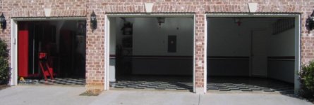

View from outside (sorry for the poor lighting). Yes, I need to plant a bush between the left 2 bays. That's planned for next month.

With your prepping the tiles with 80 grit and coating with epoxy, adhesion should not be a problem.

The floor is great. I just completed a 1100 sq. ft. garage this spring and will be doing the interior this winter. I think you've sold me on the VCT/Epoxy floor. Only concern I have with your garage is the placement of the gas water heater. I don't know what your local building codes are but every location I've ever worked in that is noncompliant and un safe. It should be in an enclosure (it's own room) with it's own combustion air inlet.
Take Care

Very well done! And it looks stunning.
Sorry to bring up a negative point but, I have one big concern and that will be yellowing of the epoxy on the white tiles where they will get sunlight (thru the windows and near your open doors). Naturally this will not happen overnight. But, I would like to hear from you on this thread a year from now and beyond if this does happen or not.
Thank you for the words of caution. Before choosing the finish, I had read in these forums about the sunlight causing yellowing of clear epoxies, some much worse than others. My garage has no windows, which I like for security reasons. The only time sun light gets in is when the garage doors are open, when driving in and out, welding, or using stinky chemicals.
The posts I've found about yellowing seem to be mainly on the thicker, higher solids epoxies. I'm guessing the yellowing looks worse on those because there's more product there, but I'm not a chemist so it's just a guess. I actually don't remember any posts complaining about yellowing of the Quikrete or Rustoleum products, but I could have missed them.
I will do future posts with updates on how it holds up, and will include noticeable yellowing if it occurs.

I did my VCT garage floor in 2006. Had I known of epoxy coating I probably would have gone that route. When my wax needs to be stripped within the next year or so I'll probably lay down some clear epoxy with anti-skid as well.
Well done and nicely documented. Thanks for the ideas.
Thanks! BTW, your posts were some of the ones that helped convince me to go with VCT.
