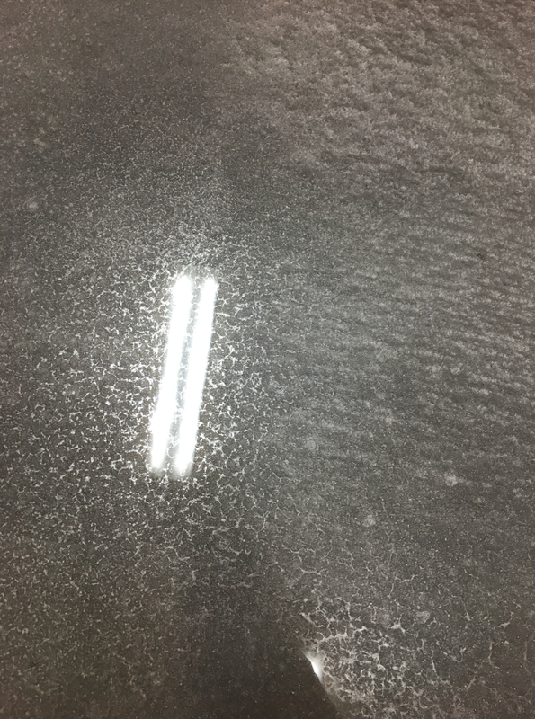

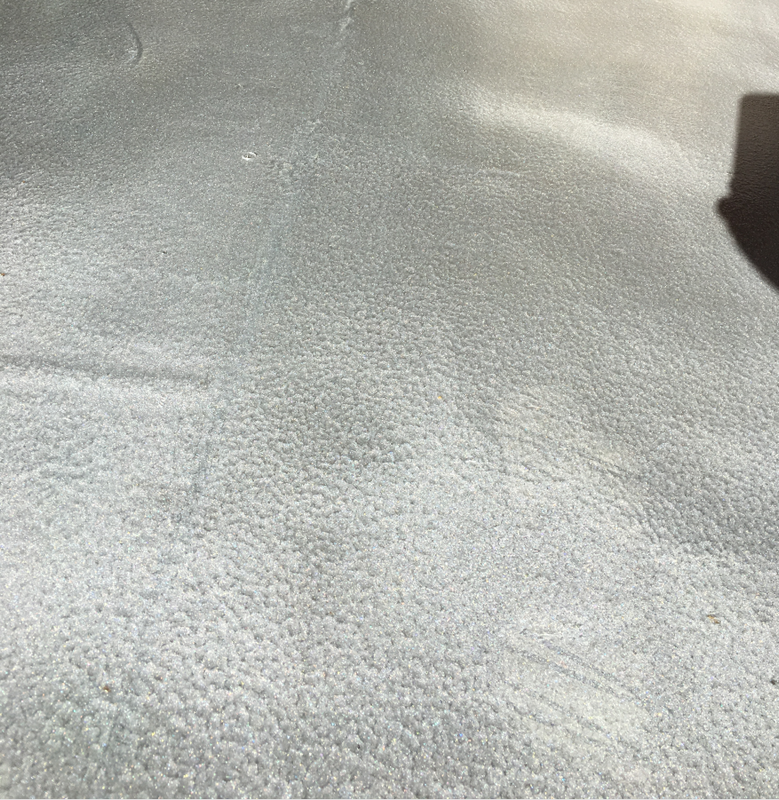

So we went to a professional shop and the guy could feel our hesitation towards flakes and proposed to us to replace the flakes by tiny quartz balls. He said we would keep the anti slip feature and showed us some of his work and i must say i really like the looks of it. Cant see each individual ball from standing height and the texture is close to matte.
Has anyone got any experience with this tyoe of floor?
Thanks

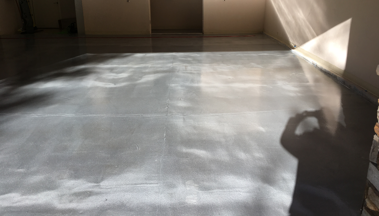

Here's a flaked floor that has a somewhat different look to it - I don't think anyone would describe it as "vintage." I did this one for my Las Vegas house. It is geometric, because the house itself is very modern & geometric.
It is flaked with very small flakes using a medium broadcast and also using three separate colored epoxy flood coats (a light grey, a medium grey, and a dark grey).
The clear coat on top has a friction enhancer; it isn't slippery when wet.
