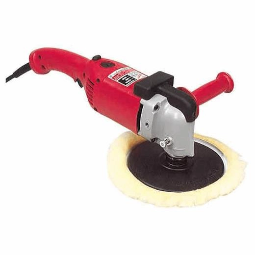

I just got an old Milwaukee 6020 sander/grinder.
They recommend type C grease in the manual, but then say that it was later updated to type G grease in their recent grease catalog.
I'm just curious if there is a cheaper option that would work (type g is hard to find, and then it's $25-30 for a pound!) Would basic moly grease work, or is that even cheaper?

Molybdenum black grease that not too thick and tacky be a good match to the type G I would expect .

So you're saying moly grease would work, but it can't be too tacky?
Or that none of it is tacky enough to be a problem?

Can't be too tacky or solid consistency, wants be a medium consistency (most grease will be classed number 2 for a medium consistency) very much like your average cv molybdenum grease .

What you're describing is John Deere Corn Head grease and it works in exactly the same manner. I've been using it for years on all types of grinders and polishers for exactly the reason you mentioned.

Incidentally, I just am refilling my same tool 's grease vault, and I found out the G grade of grease as recommended by Milwaukee has been superseded in all applications calling for it, by type Y grease. 'The Word,' from Milwaukee's hot-line.
The type Y grease becomes liquid under load so it flows into the gearset, where a thick grease would just get flung-off by the rpm's, and not perform adequate lubrication. When the type Y grease cools it becomes more-viscous.

Wonderful. Thank you for that clarification. The Milwaukee 6230 Deep Cut Band saw asks for NLGI 1 (one)
Both type G and type Y are NLGI 1 so I suppose it should work just fine. In fact, I bet any lithium or moly NLGI 1 would work fine. Many are quite a bit less expensive than the Milwaukee or Deer brands.
