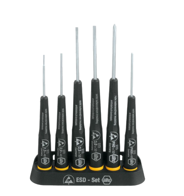

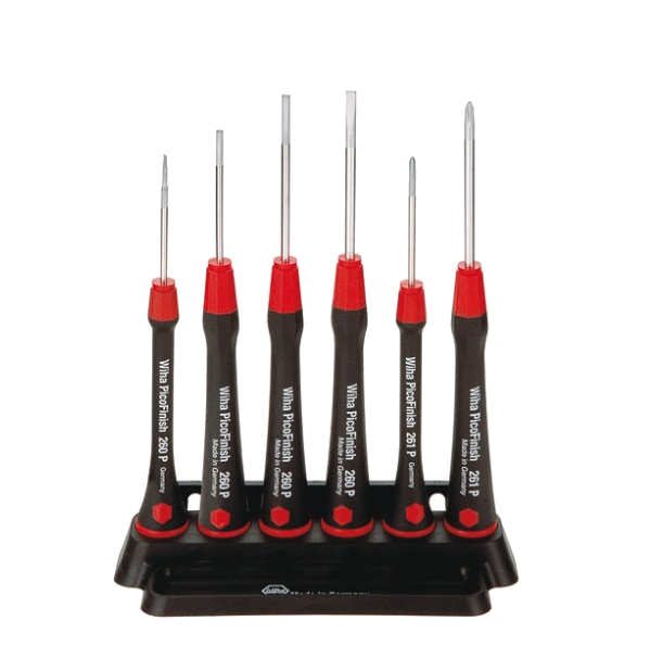

I'm looking to upgrade my set off precision screwdrivers and I was wondering what you guys thought of the ESD versions of these type screwdrivers. I've been working on electronic components for some type with the cheapest kind of metal screwdrivers there are and never had any problems with static discharge (I am wearing a wrist strap).
Is this extra esd protection actually of any benefit or more of a marketing thing, pretty useless if you're wearing a strap anyway?
I need to add pictures to satisfy this crowd ;), so I was specifically looking at these two sets:
Non ESD
ESD:
cide1

I finally went for the top (non ESD) set, cause it just didn't seem worth the 10 extra bucks. Bought it together with a lot of other electronic goodies on a dutch group buying site ==> really cheap :)

The idea is to have an unbroken static grounding path from the device to ground. The esd safe handles are made from a plastic that is static conductive. As mentioned, most of the other precautions, like touching ground, ESD mats and wrist straps will usually be sufficient. But if you want the maxumum protection, the logic behind the ESD handles makes perfect sense.
