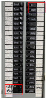

model # of panel?
Eaton BR4040BC200 is the model number.
Two slots are taken up by Eaton Surge protector. Was tempted to just remove it and free up slots for EV charger...
I just realized I need a 240v 20amp for my lift as well so I will need 4 tandem breakers unless I remove the surge protector.
Thanks again everyone for all of your help!

Is the surge protector on a breaker by itself? Some of them can share a breaker with a load. Maybe your lift can connect to that.
dave*99
May 5, 2009
4,399
Coastal NJ
Check the breaker on the lower left. Is it a Square D breaker? If so, it should not be in an Eaton panel. Hard to see in the photo.

Panel isn't rated for tandems. Just add a subpanel next to it. I see it's flush mount, how much space is next to it?
Wow - Nice catch. I saw that as well and planning to swap out with Eatons. I think I saw a Siemens up a the top - evidently BR breaker was made by a few other companies.

There are a few different breaker types you can physically stab into the panel. But the only ones that belong there are those listed for that panel.
JohnX14
Jun 2, 2014
698
Boston 'burbs
BR is a line that started as Bryant, and expanded to Challenger, T&B, General switch (I think or it was a knock off in the early '900's) and landed at Eaton.
A number of breakers will fit the BR panels. Siemens/ ITE, Homeline, Murray, as Dave stated.
I wouldn't lose sleep if I had one of these in my BR series panel.

So... I got bored and called Eaton. Mentioned the part number and they said while local codes wouldn't allow it since load center isn't designed to have more than 40 circuits, it would be OK to use non CTL (BR1515 for example) tandems in this load center.
