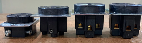

dave*99
May 5, 2009
4,331
Coastal NJ
That $9.99 Chinese receptacle from Amazon is the type of receptacle I was talking about, and would never use. For non-EV purposes a Legrand receptacle from Menards isn't that much more, and a Leviton is a few bucks more at HD.
The Leviton is pictured above. Post 48 on the left.
mm08822
Jan 13, 2012
6,233
I used the Hubbell based on my research....
Take a look at the photos of the different receptacle brands in the first post on this thread.
They photographed all the angles, but this really caught my eye:
This info is about 5 years old based upon the posting date in the tesla link.
Leviton now has their own equivalent EV rated 14-50R device and labeled as "Heavy Duty" with the eCar symbol.
The differences between HD and the standard version are:
  • higher torque requirements (75 vs. 40 in-lbs) set-screws vs. screws
  • Copper only connections permitted
  • Larger contact surfaces (hence the depth)
  • Nylon housing (for slightly higher heat resistance, better UV protection, different flame rating)
