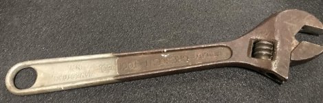

Love the stuff. Have a vise handle that was straight but beaten to near death and then allowed to obtain an excessive patina. A little brake cleaner to degrease it and into the bucket. Now it looks like a steel vise handle beaten near to death.

Sheet, that wrench just needs to do some work to look prettier if it matters, all mine look like that though. I aint gonna mess with them if they look that good. Ha
This one was left out in the rain for a few weeks in NC, scrubbed it with penetrating oil to get it working again and then dipped the back. I'll see if I have something really bad to soak tonight, or you could ship me something that's a lost cause, perhaps an old 6" vise? 😀
