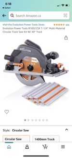

I picked this guy up a few months back as a stepping stone before I made the full commitment on a Makita track saw for wood. I wanted the metal capability as well knowing it would be somewhat of a sacrifice “jack of all master of none”, but have been pleasantly surprised. Used it to cut BILs melamine kitchen panels, counter (with proper Freud melamine blade $60), then just last weekend swapped to the Evo steel blade ($50) and cut 5-6 steel panels 0.120” thick (with the handy track for perfect straight cuts) and it didn’t miss a beat. Highly recommended for the $$.
Evolution Power Tools R185CCSX 7-1/4" Multi-Material Circular Track Saw Kit W/ 40" Track https://www.amazon.ca/dp/B07T4CZP31/?tag=atomicindus04-20. Loud as all hell and chips are just the cost of cold cutting metals. Agreed on the danger aspect of a steel sheet on a TS. Just too much to go wrong.
