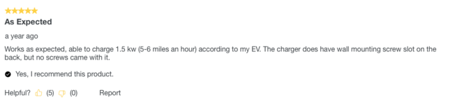

This 120V EVSE claims to provide 15A on a 5-15 plug.
Is Lectron wrong for doing that, or is the homeowner wrong for plugging it into any old 15A circuit? Or is it totally legit?
mm08822
Jan 13, 2012
6,113
They covered it with these 2 statements:
"All you need is a dedicated 120-volt outlet and the proper wiring."
"It is highly recommended that the installation of electrical outlets for the charging station be conducted by a licensed and qualified electrician, adhering to the National Electric Code (NEC) and relevant local codes. Local codes take precedence in case of conflicts."
We all know the happy homeowner will plug it in to the closest recept and wonders why the circuit trips for the older builds that don't have the now required 20A recept circuit in the garage.
Sparky needs to be smart enough to realize this is a 15 amp continuous load and needs a 20A circuit.
u3b3rg33k
Dec 18, 2017
4,051
it's entirely possible this is a "boost" feature.
80% derating is required for EVSEs, BUT, that's assuming it's not smart.
example: I have a plug in induction hob. once per power on, it'll pull 15A for 10-15 minutes, before derating to 12A, for a faster boil.
this is allowed, because it's not CONTINUOUS.
an EVSE could advertise 15A to the vehicle for a period of time, and so long as it drops the pilot signal down to 12A after a time (3 hours? IIRC), then it's not out of compliance.
for it to draw >12A continuously, it needs a 5-20P, no matter what.

From the user manual........
Doesn't seem to be a boost only......."NOTE: The charger requires a 120 VAC split phase ( :lol: ). It draws a maximum of 15 Amps of continuous current."
And it is more **** from China.......More copy/paste but no clue what they are writing: "Connect only to a circuit with 50 amps maximum branch circuit overcurrent protection to reduce fire risk.":headscrat
"for it to draw >12A continuously, it needs a 5-20P, no matter what." Not no matter what, b/c a 15-5R duplex can carry 20A as it is permitted on 20A circuits.
you're allowed to have 20A circuits with multiple 5-15R on them, but I think the intent is to avoid nuisance tripping, not to allow for naughty appliances. I believe appliances are still required to have plugs appropriate to their design draw.
so somehow it got ETL certified as an EVSE, but the cert doesn't appear to address the draw, just specific safety items.
as best i can tell this is technically "naughty" but i'd be curious to see if it's actually a 12A L1 EVSE.
the comments imply that it is
Denwood
Sep 22, 2014
4,237
Thunder Bay, Ontario, Canada
The 20A circuit with multiple 5-15R is a code compliant alternative to 15 amp split receptacles used for many kitchens here. It for sure reduces many nuisance trips.
Any EVSE allowing more than 12 amps on a 5-15R type plug is an unacceptable fire risk IMHO for the uneducated public and I’m assuming none of them would have UL/Intertek approval. I have one of these cheaper EVSE’s that will allow you to select 16A@120V and use it only at camp on a 30A RV circuit…but would never recommend it to anyone for this reason.
