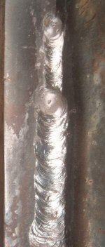

I am a yup it works good guy too. No, these were not tig but sticks. Some 6011 and 7018. Super common for equipment repair. I have done this a lot, i am still impressed as to how good this welder really is. I am not in current practice. If i was welding regular for a couple weeks could really refine it and be critical.
With small electrodes on smaller material, critical small note pipe etc the current can be fussy within a couple amps and even influence real deposits quality, even some grain structure if the electrode is operating at exact the right current.
When I was a daily driver could tell some minute changed in some of it, not much between machines.
This doesn't include dowhill pipe specialists that like a bit different setting but vertical and overhead structural and pipe.
