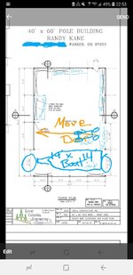

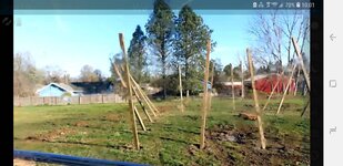

Pole barn. I have to get my poor boat out of the weather.
Here is a preliminary drawing. It shows the drive through for the boat which is 38.5' long on the trailer. Room for my subcompact tractor, JD1025R. Benches for rigging, tearing down reels, melting lead. Storage for rods and gear (halibut, salmon, bottom ft fishing & tuna). Tiered storage for tractor implements.
Just my notes.
