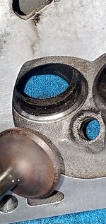

I'm attempting to lap these valves and as it's my first time I'm not sure what is normal wear.
02 sierra 4.8L 360k km truck ran fine, great actually. Heads were pulled for a coolant leak. Never overheated. Serviced regularly, all other engine components are in remarkably good shape
The first 3 pictures are the exhaust valve I've started on, the second 3 are an example of one I haven't touched yet
The seats look polished because I already cleaned the head and it was unavoidable. I used a rubberized abrasive rotary brush specifically for cleaning aluminum heads (name escapes me, gasket surface cleaning tool)
The burr at the edge of the valve concerns me so I stopped before I potentially damaged the seat
Looking for suggestions on how to proceed

like Jack said - just have them reworked properly. seats/valves/guides/seals/

It's always hard to tell from pictures but both the seats and the valves look salvageable but you're not going to do it with lapping.

They’re worn and need grinding, not lapping.
That said, it’s probably not much more expensive to just replace them as others have said. Grinding is fas becoming a lost art.
Definitely have the seats touched up. Your scotchbriting didn’t do anything to address seat wear. Have the machine shop replace any worn guides.

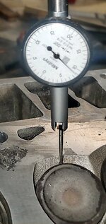

Not too late to check, I should have thought of that. From 0 I have 10 thou at the edge of the valve on open. I have no other way to measure the guides

Is this coolant from pulling the heads? You should’ve cleaned that up right away and poured some oil in the cylinders to keep the lubricated and rust free.
.010" ?!?!?!?! :eyecrazy:
I’m not sure what he’s measuring there? Is that side to side lateral movement with the valve opened? 🤷🏻‍♂️
Yes, I couldn't think of any other way to measure the play in the guides
