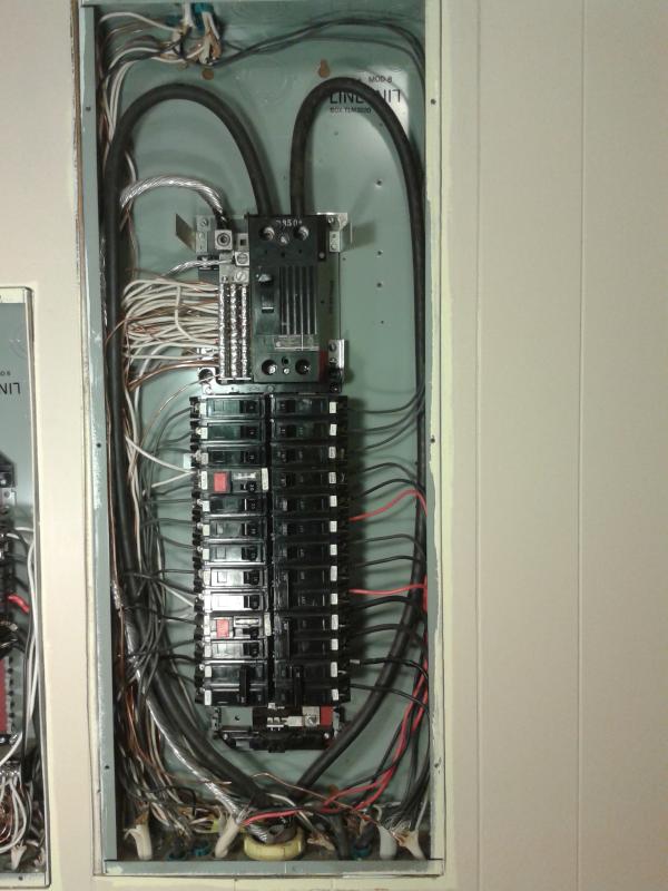

Recently bought a house that has a main panel and a secondary panel next to each other. I believe at some point the lower level was finished, the garage was added, and a sunroom was put on which prompted the second panel for expansion room.
Main panel is 200A, second panel is 100A.
Currently the garage has a single 20A circuit feeding all of 3 outlets, and this circuit is shared to an outside shed. Don't like that set up. I want to add another subpanel in the garage and rewire for more outlets on different circuits, and add some 240V outlets for future welder, air compressor, and an 18k BTU window AC unit. I would like to make this a 100A service inside of maybe a 200A main panel for space.
Now here is the oddity: the two existing panels both seem to be fed from the main service entrance/meter. The wire feeding the 100A panel doesn't seem to enter the 200A panel at any point.
200A panel:
100A panel:
SO my question is: can I add another panel for the garage in this context? There are 4 empty spaces at the bottom of the 200A panel, two per side, in which I could fit a 100A breaker. But, would I have an issue with potentially overloading the house service since all of the panels don't seem to go through a single main breaker? Would there be another breaker inside the meter box (I don't think there is?).

Each of those panels has its own main disconnect. Looks like they double tapped the meter (some are designed to be double tapped, so this could be a legitimate situation). You could easily add a breaker, say 60 amp or 90 amp in the main panel and run it to the garage. You cannot overload anything as the larger panel has a main that will trip if the combination of the house and the garage exceed the 200 amp. House circuits do not draw near as much as most people think. Water heaters, electric heat or heat pumps and electric stoves and ovens are the largest draws, the remainder is an amp or two here and there.

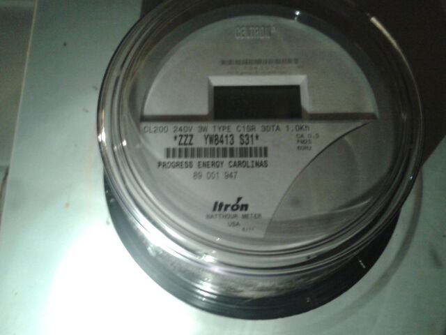

Not to beat this into the ground, but I'm still confused/concerned about this double tapped meter situation.
I looked at the front of my meter. It is an Itron Watthour Meter and says "CL200 240V 3W TYPE C1SR 30TA 1.0Kh"
Based on that I would assume this is a 200A service meter, and thus my house service would be 200A and not 320A or 400A. And as such, if my 100A and 200A panel are both independently connected to the service entrance, I could *theoretically* pull greater than 200A from the service. Granted not likely to happen, but this seems like it would be a code violation to have the total panel draw with rated breakers over the service rating.
I called my power company and they told me they don't have any records on file as to the size of my service and that I would need a qualified electrician to look at the meter. But the meter box has a security tag on it, and I assumed this would be a power company thing to open, not some random electrician. Aren't there fines for cutting off those tags?
Maybe I'm getting wrapped up in this "by the book" but when it comes to stuff like this I want to be extra sure.

I'll have to calculate it all when I get home, but it *is* an all electric house.

Here is the meter. Sorry for the dark picture.
As I said before, it does appear that it is a 200A meter.

There are few 200 amp meter sockets with actual double taps. I would not be surprised if this is a less than kosher double tap.
I would talk further to the power company. You really need to talk to an engineer who sets up new and replacement services. It might be worth it to have them come out and tell you what it would cost to replace the service cables to the meter (if they are not suitable for 300 amps) and replace the meter can. They can tell you if you own the meter can or if they do.
If you replace it and have to provide the meter socket, I would use a combination unit that has the disconnects built into it.
