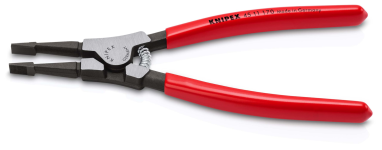

The ones with pin tips for circlips are common, but I'd not seen ones with flat tips until recently. These are designed for plain external lockrings, but I wondered if they're useful more generally.
Like an inverted flat nose plier. The tips open when you squeeze the handles, the opposite of normal pliers.
Seems many a time I want to spread things apart then hold them there, you could use these instead of pry bars and fingers.
I found the below candidates whose tips are textured and not specialised for lockrings. Other models with those tip attributes wouldn't lend themselves so well to general use. Anyone use these or others, or could see them coming in handy?
Wilde G407.B 9" (photos from this post)
Knipex Special retaining ring pliers 45 11 170 (7")

I have a set of Wilde pliers that are probably 35 years old and they have a compound action that keeps the tips parallel as they spread.
I honestly only use them for their purpose of snap/retaining rings.

That style of plier is called lock ring pliers… if you ever need to google it.
I have mostly just used them for lock rings, but occasionally I have used them to spread other things open.IMG_5843.jpeg

If you ever found yourself using basically any pair of pliers “the other way around”, you’ll come across a use for these again sooner or later.
In fact, a couple of days ago I used my BluePoint int/ext snap ring pliers (that tend to get a lot of hate) to open & hold open a gap and pour some super glue in on something I repaired. If the gap would have been a bit bigger, the Knipex 4511175 would have fit. 4521200 is interesting as well.

I have two pair of expanding pliers and used them often. They each had only one job in my shop and they performed perfectly.
These are branded Craftsman.
These are branded Williams(?) with compound parallel jaws and worked much better than standard snap-ring pliers here.

These aren't quite what you're looking for, but they have the same action:
Lisle 47900
KTC ABX-32
