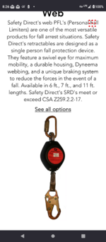

#1; don't fall!
#2; don't step on air lines!
#3; keep the rope short enough that you can't fall off the edge.
If you can find a retractable style lanyard that works really well to allow you to reach more area without always adjusting the line. Look for used and sell after you're done.
I'll see if I can find an example and come back and post a link...

I looked at that option but I'm going to stick with the lanyard with the fall deceleration in a folded, stitched design. That is proven to work well. Also, I don't want any excess weight or a reel bouncing around either on my back or on the roof, however they are used. I'll be on a 6/12 roof and the lanyard will easily freewheel along the lifeline. I can see if I was doing this where speed of production was important. For me I will just be putzing along. No deadlines, no foreman (besides my wife), no rushing.

If you’re not wanting to buy a retractable reel, then consider something called w rope grab. You can slide them up and doen your nylon safety rope. They’re nit expensive. They’re made for use with a vertical safety line, like hanging from above, but should work for you. You could rig up a pad, I guess, so it’s not rubbing your roof. Retractable reel at roof peak would be better. Not a roofer, but used these in construction/welding on buildings.
Good luck.
