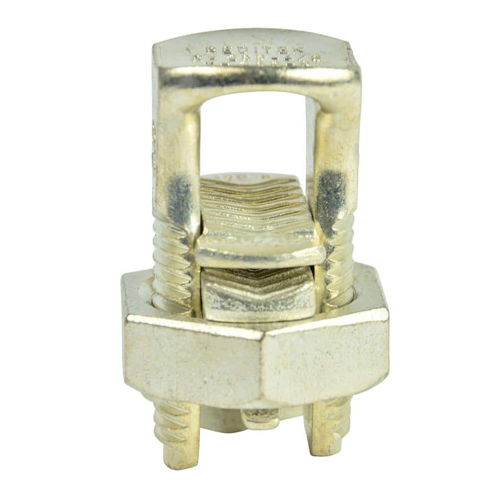

Any product recommendations to extend neutral service entry wire that comes from the meter into the service panel?
Need to extend the 4/0 aluminum neutral by 6”’and looking to see if there are any good options other than having POCo pull the meter and then running a new cable.
reading through other posts looks like NEC allows it.
something like this may be:

Why are you needing to splice it, are you doing a panel change. Is the splice going to be inside the panel. Is the service entrance conductors/cable going to be the right size for the new panel. Is it copper or aluminum. It seems like it is allowed per the NEC

I wouldnt use the splice kit you linked to. thats for underground use as it has gel in it. use kearney bolts or split bolts...
Great info, thx.
Adding to this, what type of connector would you recommend to extend branch circuits? I will need to extend couple of hot wires on 15a and 20a circuits.

Split bolt wrapped with splicing tape on the service wire.
Tan wire nuts on smaller wires
Thank you.
you mean something like below for split bolt?
Yes,that's a split bolt.
Looks like big box stores around here are out of stock on them. What are the thoughts on using the connector that user “stuff” shared above along with splicing tape?
Those would work also. As far as splicing in the panel, we are allowed to do it here. We are allowed to extend conductors to reach to breakers and lugs. Always check with local codes. I personally never splice the service feeders, but thats just me. But then, being licensed here, Im allowed to pull meters to replace the cable. So it sounds like you are doing this hot
