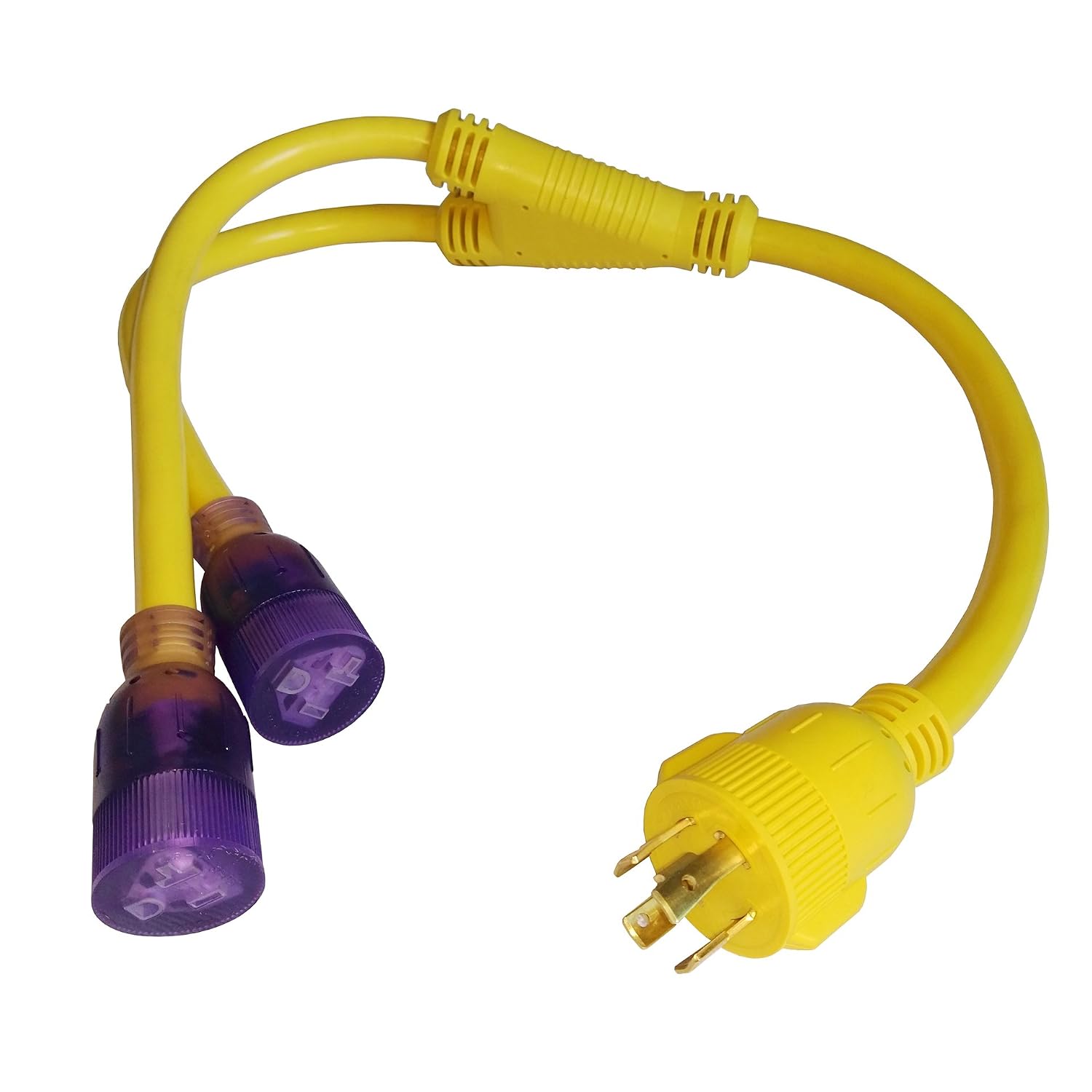

Ya, I have seen a couple of these gems at fleas, not a bit of writing on it. Another 30 to 15. could plug a power strip in to it I spose.
Wiz,,, that one you posted says UL, wonder how that is so? Maybe someone with minds greater than our own can explain it? seems like there would need to be a breaker. They say something about generators, wonder if there is something around that?
I don't recall any overcurrent on welders, cant recall if they had something internal self resetting etc. My helper is gone a couple days, I will have to ask him. It seems I wonder that before but didn't ask anyone. I am sure someone here knows.
wyliesdiesels
Aug 14, 2012
20,279
Modesto, CA
Wheres the U/L wrap around sticker?
I dont see one. Maybe i missed it...
