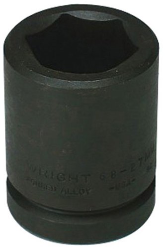

PoorUB
Mar 29, 2021
11,710
Fargo, ND
I would be surprised if you could not find a stamped steel socket that size. I know you can buy them up to around 5". Like this, large socket
Some bar stock and a welder you could make one.
Mgdoug3
Mar 2, 2018
1,391
KY
That's what I was kinda thinking. Measure the flats, cut out some 4" flat metal and weld it together. Next weld a plate on the back and a handle to it and you're ready to go. Those kind of projects have always been fun to make for me.
