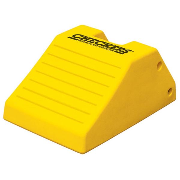

Several times I have needed to keep a very large tractor from rolling while working on it. I am able to find wheel chocks for semi trucks but nothing larger. I would like to find or build a extra large wheel chock. I have used blocks in the past but they are very heavy and not easily transported to the field. Anyone built anything or aware of one’s I could buy? The tires I am looking to chock are about 50” in diameter

Are these big enough?

Real good on size - looks expensive for what it is but may have to buck up and buy

You could make the outer trapezoid frame from 2x12 and glue and screw ¾ or 1 in plywood for the sides to that. Paint green, red, or orange.

What are you considering up be very heavy? I've made wheel chocks from a few layers of 2x cut to the right shape. I've welded up triangular "space frames" in whatever size was needed. I've also stood plywood triangles on edge layered up to give the width I wanted. The lightest was the steel. The coolest was the plywood. The simplest was the 2x. All were pretty easy to build.

What I have been using are pieces cut off large beams 10x10“ and 12x12” probably 16” long. They are big enough where it takes two hands to move and I am sure they are 20-30lbs each. I am sure if I made them angled it would cut the weight in half.
really appreciate all the replies. I think it’s ridiculous to pay 400.00 for something I can make and work equally as well
