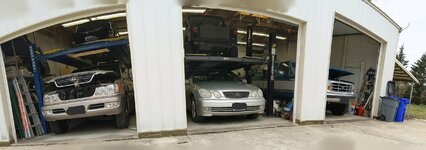

Z
zaius
Aug 19, 2024
18
Thanks everyone for your reply!
I have a high lift garage door with a side mounted opener already.
I can purchase the aluminium ramps (or race ramps) to make my life easier.
I guess I'm debating if the extra long is worth it as a car below will be driven in and out daily, especially in the winter. The only con I can really see is it might limit moving stuff around in the garage.
This is what my garage looks like

Looks like a potential forehead basher unless you have the discipline to park the lift very high up.
Part of the reason I selected my lifts was the removable aluminum ramps were standard.
The plastic/ foam ramps a couple of posters talk about might be even better.
The aluminum ramps store well on the runway.

The stored car will be raised above my height, as I have enough ceiling clearance. No need to wear a hardhat around the lift.
