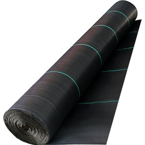

I just ordered TrueLock HD Extreme Diamond 12″ × 12″ × ½″ Garage Floor Tiles for my shop rebuild. My garage floor space is about 1,500 sqft.
I have read quite a bit about using landscape fabric under the tiles. I would like to be able to sweep/blow out the shop occasionally and once a year hose it out. The shop will be used for vehicle storage, a 4 post lift, wood working and general guy stuff.
Can anyone comment on if the product below would work well under the tiles to quiet them down a bit?
VEVOR Driveway Fabric Stabilization Geotextile Fabric 13x108' Underlayment Black
My shop build and rebuild story is in my signature. Thanks for the input!

I can't comment on that exact fabric but I put the standard weed block under my tiles in my workshop attic and it made a nice difference on the plywood floor. Keeps thing quiet. The fabric cost me $20 at Lowes.

First off, anything vevor brand should be avoided.
It’s crappy copes of the actual thing
Second, can you explain the benifits of this? Are you on concrete or on dirt?
If on concrete I just can’t see any benifits.
If on dirt I can see a benifit but I can better see putting down DG and compacting it

Thanks everyone for the input. The HD coin tiles are on the way so I will work with those. I will check on some other landscape brands. We grow blueberries and use a weed mat product, which is more heavy duty than basic landscape fabric, I may try some of that.
After all the reviews and research, I have just been concerned with the free flow design not because of the tile, but we live on a ranch in Oregon where there is A LOT of dust, dirt and sticky mud. It is a 2 mile drive on gravel roads to get to our house. In the winter those roads are muddy and in the summer very dusty.
In my mind, I would prefer to see the dirt on top of the tiles and sweep, hose and blow the shop out instead of knowing that it is imbedded in the free flow tiles and have to work to get it out from between the openings in each tile.
If we had paved roads around here, the free flow tiles would be ideal, but I just can't imagine what they would look like after a winter season with 60" of rain and several inches of snow with our gravel roads.
I will keep you all updated on which fabric I decide to go with.

Agreed. Same here, no fabric under FreeFlow. It's not needed since they don't make the "clickety clack" that solid tiles do. I used non-woven landscape fabric under my prior diamond tile floor and it made a big difference in noise reduction.

I put one layer of fabric under TrueLock HD Extreme and it is still clickety clack. Suggest 2 layers, as it is cheap and easy to put down.
