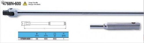

M6erfan
Dec 6, 2014
10,170
'Merica!
Actually I have the wrong pic in my previous post, the handle on mine is knurled so not slippery at all, very comfortable.
Here is the one I have...
As Doc said above, Koken is a Japanese company so it may be available to you
