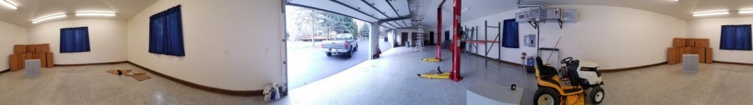

Thanks guys yeah that's kinda what I'm doing is putting things in temp places. right now I'm still just moving things over in boxes and just putting them on shelves for now. I will unpack later but I have a lot more room than I thought I did. Nearly brought my entire garage over with the exception of my toolboxes . My new compressor is going to go to the right of my engine stand and I may have to take one of the shelves out to clear since it's pretty tall but it's nice having a storage space above it. Eventually the welder, plasma cutter parts washer, press and sand blasting cabinet come in bit I have more than enough room for them. found a great deal on a tire mounting and a balancing machine so those might be the next things to come over here . Feels good to finally make some progress over here now I just need to figure out how I'm going to get more to 220 outlets. Have one on the wall by where my compressor's going to go & two in the ceiling for the lifts. Any suggestions there? The 220 is being a wall wall plate.

Newest panoramic. kbs, can you elaborate? how would 3x3" angle iron up front help? I'm having an issue visualizing this. I was going to try the 2x4 idea as A. I don't want to spend a small fortune on a countertop and B. I'd like to get better with wood working. However if it's very difficult to make it work well then i'll just not attempt it.
What would 3/4" plywood accomplish at the outside edges?
What is 3/3 plywood? Googled it but didn't find much. Did I mention I'm not a wood guy?? :)
Dave

I didn't catch what you want to use the space for. Are you shooting for a suburban let's-not-spook-the-soccer-moms garage? A lift friendly steel body race car fab garage? A "do it all I dont trust anybody to work on my stuff" shop? A I need to store 15 original VW garage?
You certainly are off to a good start. I have a soft spot for pallet racks. Is there a used dealer nearby? You could build something like levrack. http://www.levrack.com/?lightbox=dataItem-j822bx4s1
The panorama just confuses me. Is this an ell shape?

It's just my hobby shop. I'll eventually build another car, take something apart , build something, 3d print something, etc. I have a customer who is moving who offered me all the racks that I want. I'm actually thinking about modifying one of those racks cutting it in half vertically and making a top for it, putting it in casters so I have a mobile 4x8 bench. For the most part I am probably going to make an island so I have access to all four sides of it. probably mount my drill press, my grinder and my vice to it and then wire it in a way where I can quick connect/quick disconnect. If I start welding more i may redo the top in plate steel so or can also double as a 4x8 welding table. Using the rack as a table was actually my wife's idea

I won't tell her lol. But from a non gearhead I'm impressed. To answer the question it is not L-shaped it is rectangular and is approximately 70 x 22
