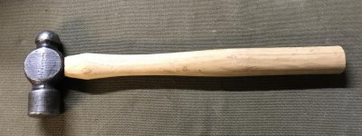

Here is my Fairmount auto wrench that I believe is correct for a Willys MB toolset and some re-handled Fairmount ball pein hammers.
-Don1F6A3849-9A4B-4E1F-AFC7-01225ED72CD7.jpg0DFE4FCC-A248-4AAA-AFD5-7724459553FE.jpg7999757C-54C3-4FC6-8FC8-452570579E53.jpg550C5649-691D-43BC-87BF-091D0142D0A1.jpgC390CC8B-765E-4AF6-B575-872764A80A4D.jpg2908FAFB-F78E-44E2-AAA6-8C8ECE864B6C.jpg

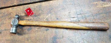

Snagged a vintage 4-oz. ball-pein at the flea this morning. Bit o' flip-worthy gold there because these are not common, the GMTK had 4- and 32-oz ball-peins, and Fairmount is a popular wartime brand. That two-tone handle, which looks kind of cool, is not original. Or rather, the second tone isn't. I favor wire whipping to repair cracked handles, but someone did a very nice job on this one. I suspect there is a longitudinal pin or screw involved. Even though there is a little separation, this thing is solid. Nice, deep marking.
outofbounds
Oct 23, 2019
1,393
That is a peach there. You can take that and the Bonney you were showing, and get a side gig as a xylophone player perhaps. Both are awesome.
