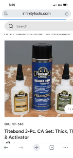

Likewise, CA glue with accelerator is what instantly came to mind.
I use this all the time for wood trim.

Not at all. It’s a clear solvent that evaporates quickly. You spray the lightest mist you can and assemble fast. That stuff is crazy strong and crazy fast. If you want both it’s the only way to go. Hot glue is a joke compared to this stuff.
The instant bond is a good idea. You might be able to apply the glue to the slot, insert *** he tab and then dust on the accelerator to build up a bonding system.

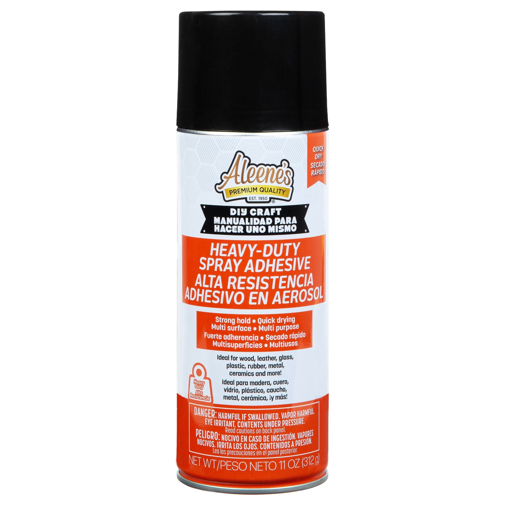

Another option might be to put the model together, then spray glue the whole thing.

So, I went shopping. Home Depot and Lowe’s showed on their website that they carried the Instabond brand accelerator and CA glue. They did not. While I was out I decided to stop at Hobby Lobby to purchase a cheap laser cut wood kit. I bought Leonardo Davinci’s helicopter kit. I had to go to the Woodworkers store to find the CA glue and accelerator on the shelf. Spendy at $45 for both.
Opening the kit I decided the bright wood color and razor sharp edges needed to be changed so I tore off some emery cloth and started sanding. After a while my fingers were cramping up from holding the tiny pieces so I decided I should glue a piece onto a paint stir stick and make a sanding stick. What a good way to test the glue setup time!
Following the directions I sprayed the end of the paint stick with the accelerator. A then made a few zig zags on the back of the sandpaper and pressed it into place wiggling it a bit to see how quick it set up.
It immediately glued the tip of my gloved finger to the sandpaper and when I tried to lift it off, tore the glove. Then when trying to grab the sanding stick off my paper covered work surface the bottom of the paint stick was securely glued to the paper. Neither of those surfaces had accelerator on it, the over application of glue dripped under there and made them one. With my knife I cut it free. I’m only sad my grandson wasn’t there to see my major fail as we both would have been laughing a lot.
The model uses lots of dowels cut to length and of different diameters. They fit into their drilled positions both loosely and press fit tight. I attempted gluing before hand and pushing the dowels into the holes and also pushing them into the hole, then applying a little glue and the meerest of spritzes of the accelerator. You could see the glue bubbling and then turn opaque drying very fast. This dried glue looks poor and makes it look sloppy so scraping or sanding cleans it up but not without difficulty around the dowel bases.
Several of the dowels with slop I attempted gluing and the placing in the hole moving it around to see how long it might take to dry without accelerator. I could move it out and back again quite a while before the glue starts to set, so the accelerator is really the way to harden the glue quickly and lock it into place.
As far as the bright white finish I ride some coffee to stain it as I didn’t have any water based stain.
I like a nice torch coloring for wood, so I got out my plumbers torch to add some vintage color to the assembly. This is what I will do, quick and easy.
All of this was to test what to do and what not to do on Sunday when my grandson plans to come over and assemble the wright brothers plane model. We will practice on the Davinci model first and see what method he prefers. Both models come with glue, so maybe we will try those out too. Looks like white Elmers glue.

There’s definitely a learning curve with this glue. I can from the pics you are using far too much glue. A little goes a long way. Were you at least happy with its strength?
