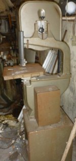

Here are a couple items mom-in-law wants sold that I actually know what they are, but I have no idea as to their value. As far as I know (and my wife knows) everything works fine. There are also some ancillary items that go with each of these items.
Any ideas on values?

Bandsaw, quick sale $200. Small mill in not so good condition, quick sale 500 to 750. With a fair amount of tooling, $750 for sure, if not a little bit more.
Edit: I just noticed the DRO on the mill. If it works that adds a bit. Wendy, if DRO doesn't mean anything to you, it's the servo motor on the table feed and the LCD display near the head. A used machinery dealer will offer you $250 and a haul away. Not everybody can move that thing so the market is limited. Pending seeing it, I'd be in the hunt.

Wow Zeke, that's wonderful information. Thank you. There's a lot of other stuff too, and I'll be posting those pics on a different post. I think I should start something new for these questions.

I'd be interested in the mill if this wasn't SoCal. Looks like the thing took a long good bath, that really messes with the machinery DRO or not. Depending on the mfg, parts may be unobtainable. Probably weighs in at 1200+ lbs. The DRO looks to be and older model Shooting Star (?), so it might be repairable should it not work.
For machines like that and any tooling, a post in the Buy/Sell/Trade section of the Home Shop Machinist board might be worth your time.
