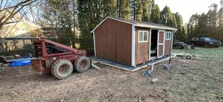

My garage and my shed have some overlap, so the shed needed to move. I built a new shed pad, 18'x14' for my 16'x12' shed. Leveled it best I could with the grader blade then dug the rest.
I called several shed moving companies. $200+ and they didn't have time to do it. Couldn't be bothered, no one called me back. After a few weeks of that I got tired, so I built a pair of pallet forks for the bobcat and did it myself, which was more of a pain than I thought it would be.

I called 6 shed companies that also provided shed movement. Everyone quoted me $200-250 to move it 50'. I said fine, lets do it. Every one of them was no call no show and when i called either didn't answer or offered lame excuses. I spent months trying to get someone to do it and now i'd sooner burn their business to the ground rather than give them money.

Got some work done in preparation for the garage. Need to clear old concrete pad that has a few foot overlap. Called some friends and bought a case of Guinness. Was going to do it all jack hammer, the pad was 1” when we started but 8” when we finished so I’m glad I broke out the hoe.

Turned a bunch of big slabs into a bunch of little pieces, then cleaned it up with the bobcat. Harbor freight jack hammer has had a pretty hard life, but hasn't complained once yet.
Now with this overlap out of the way, the footer for the garage can be dug.
