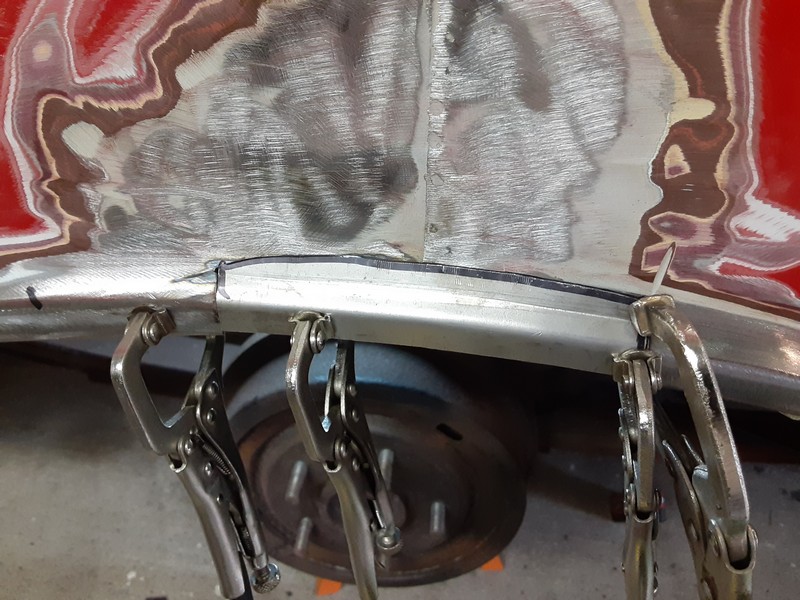

I am using 16ga. for everything (mostly) in my '56 wagon rust repairs. Of course most everything I am replacing, panel wise, is available aftermarket. The 16ga. worked well for inner cowl, lower A & B pillar patches and fender lip repairs.
A few pics for inspiration. :)
Totally rebuilt the inner cowl area with the 16ga.
Mark
