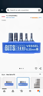

Andres26tnt
May 11, 2018
994
Looking for a kit or two for my guys. never thought about PB Swiss. That Hazet kit is pretty sweet. I'm leaning towards Vessell at the moment maybe Wiha. I like the Wera bit checks but, 6 or so of the bits will be posidrive. Thanks for the suggestions so far.
I would recommend vessel as it's generally more available and top quality. The only real drawback is they come in small holders. I usually take them out and either 3d print or purchase a holder/case. Currently my favorite case is the DeWalt toughcase. Fyi vessel is constantly more affordable for the quality.
