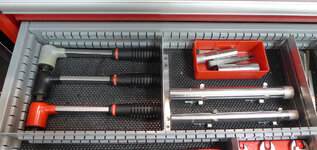

I love the KoKen sockets.
Tried a few others but these seem to work about the best. The spring clips are superbly designed, hold the plug perfectly, and there’s a bushing that protects the insulator. I’d never go back to the type with the rubber insert.
KoKen also offer ”extended” sockets, with an integrated extension, so you pull the socket off the plug not the extension off the socket. These are my “go to”.

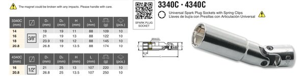

Universal sockets are also available. I’ve got a couple of these if needed (and one for injectors too).
Don’t know why these makers insist on giving metric equivalents for plugs that we all know are 5/8 or 13/16 though..!
EC50245C-07C7-4DEE-BC48-3F7811715D60.jpeg67DFC47C-CC83-4C24-AB44-30ECF30829F3.jpegB2216123-C284-4D98-854D-895250A39C06.jpeg

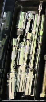

I have both the Gearwrench and Astro magnetic swivel sets. Plus a few standard non-magnetic/non-swivel sockets.
I also have a long and short 14mm Snap On (not pictured), that are not swivel or magnetic.
So I can handle just about any spark plug situation I might come across (hopefully).

Which do you prefer? I've read very good reviews/comments here about both. The GW is 11" and the Astro is 10", but I need some locking extensions anyhow so the difference in length may not matter that much. (Yeah, I can hear The Office jokes...)

Hmmm, hard to say. But if I had to pick one, I would say Gearwrench. Not because Astro is a bad tool, I just have had the Gearwrench set longer and they have seen more use.
For anything 14mm, I use my Snap On sockets.
