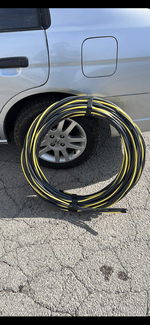

Well thanks guys!! I picked up 125’ of 2,2,2,4 quadraplex direct burial cable today. $2.15 per ft. I’m off on Monday. I’m hoping to get the conduit and trencher rented!

That's URD cable and is not allowed by the NEC to enter the structure. Are you planning to terminate this outside and switch to an approved wire for interior use? Verify the insulation rating that it's just not USE-2 only. See post #2.
Do you have the link to the product where you bought it? That does not look like code permissible wire for indoors.
That looks like three phase service entrance wire

That’s a photo of the receipt. Please tell me they gave me the right stuff. I told them what I was doing. They said this is what I needed.

Southwire "****" is URD and is not approved for inside installation. It must be terminated outside of the structure. Sorry, this is a very common mistake when purchasing wire for this purpose when trying to run one continuous run of wire panel to panel to a separate structure.
Use either MHF or XHHW or THWN.

Thank you. I asked for their recommendation and that is what they provided. I asked for MHF and I might have said it wrong. I’ll se what they can do to help make this right!

Based on your first post it appears you'll have quite a few feet of run inside to both panels. The issue with USE rated only is that wire insulation is not fire resistant rated so that's why the NEC doesn't approve it to be used inside. I've seen it get by on inspection when the feed goes directly through the wall right into the back of the panel having only the wire length inside the panel.
