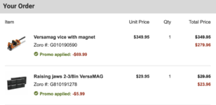

Ebay deal on this vise - they are running an extra 20% off for the next two hours, total should end up at $287.97
