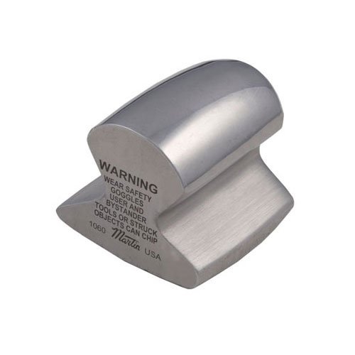

I don't like rolling fenders. If you look at the clearance problem it's only 12 inches or so at the top where the lip returns under the car. Cut it with aircraft snips and gently roll the sharp edge with a curved body hammer and
On severe jobs where the car will get painted I place 1/8th welding rod in the angle and beat the lip over on it. If you're real damn careful you can do this without hurting the paint but it takes hours.
