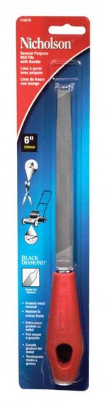

Had complete sets of Nicholson USA files from 6" to 12". Stored them in the file pouches Snap-on used to make.
Now, I just go to Home Depot or the local tool stores and buy the Nicholson Brazil and Mexico files. They work fine and the red and green handles are oil and grease resistant

So, can anyone explain why one should not buy the Mexican made Nicholson? I have been using Mexican made Nicholson's for 5 years now and have never had an issue. You can buy them cheap at Home Depot.
It was said that when they first moved production to Mexico the heat treating sucked & the files wore out really fast. They supposedly have fixed the issue since. I don't have any experience with any of the Mexico made ones so I have no idea. People still say they are not the same as the USA made ones but for the average consumer they're probably fine.
