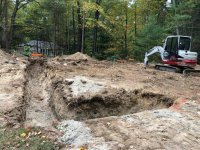

So progress has been extremely slow, it took my town forever to issue permits because of the COVID lockdown. We then went to put the screw piles in and I was told they couldn't do them because of the ledge on my property. At that point I was pretty discouraged, but I procured some equipment from work and started digging. We are doing footings pined to the ledge and the posts will rest on those. I trenched the entire thing so we could see the extent of the ledge and make sure it was possible to pin to it. Hoping things move quicker now.
I enlisted the help of my two oldest, my little guy (2) couldn't be out there helping as he casted up for a broken leg!
Congrats on overcoming all the obstacles and getting started! To be honest, I've never heard of footings with posts on top supporting a structure. It would be more common to place a footing and wall. Maybe posts are less expensive? Looking forward to seeing how this comes together.
J
Juiced06GTO
Jun 1, 2014
356
Sutton, MA
It will be a traditional pole style building like most built here. Most of the time there is just a 2' diameter hole dug, a precast footing dropped in, and the post set on top of it, then it is back filled. In my case, since we can't get down below the frost line, we had to get down to the rock, they will drill it, epoxy in rebar, and pour the 2' diameter footing to put the pole on. It saves the expense of doing a full footing and frost wall, although, I may have them price that out at this point since I dug the entire thing out anyhow.
I excavated so much because we had to make sure it was actually ledge and not just some big boulders they were going to anchor too. Once I got down there I can safely say it is just one giant piece of rock, which is pretty typical for this area I guess. I should have known there was a reason they placed the house where they did on the property and not on the giant mound in my front yard...
ConCretin
Jan 20, 2011
3,380
Central Maine
For some reason I completely missed the fact that you are building a pole structure. I think the reference to screw piles threw me. Carry on.
