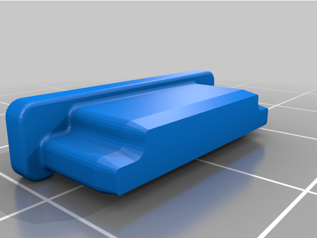

got my box set up and then realized that they only gave me 1 package of the drawer label end tabs !!
so did what i do, designed one to 3d print. came out great, used one of the existing ones to design from, and made them look the same. i did put a leading edge chamfer to make them easier to get in the track ends !! I put the file up on my Thingiverse page if anyone needs it :)

I didn't get any with mine! (Or I mistakenly threw them out)
I don't have a 3D printer or I'd take you up on that. Appreciate you doing that though!

well if you want some let me know, just pay for the material and shipping, i can print some up and mail them out. i am happy with the ones i printed for my boxes.
