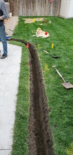

Well wednesday is the day!! Been in the house for close to 8 years and im finally getting heat in the garage!! The hard part for me is done after i hand dug the 30 foot trench down 18 inches. Plumbers will be installing a 45k hot dawg in my 24x24x8. Venting out the side. Any recommendations or advice before the guys show up?? Ill update the final install pics in a few days. 9abfc4f46208302ab5499adfa81e6173.jpg2ab0c6616e17f7af9c2fe978fa8243b5.jpg7b3f8148a25b92d8f0b8a9a3a84f1299.jpg

pbon
May 14, 2017
3,498
That is a beautifully dug trench! What do you charge per foot?
Well since it took me a little over an hour. And the trenching company wanted 300 bucks to do 30 feet. I guess i charge 10 bucks a foot. Not saying id do it for a living!! Haha

I came to comment on the trench too [emoji23] !! Very cleanly done! If you've got that level of cleanliness & organization just digging in the dirt I have no doubt your heating project will be very well done.

That's the nicest looking trench I've ever seen!
They tend to look slightly less sophisticated when I dig them with a tractor!:spit:

You vacuumed up after you dug that, come on share your secrets.
Someone mentioned **** trench?
Nice looking lawn and pooch, as well.
No vacuum here! Just used a sod cutter to strip the sod cleanly. Used a spade to dig out the nice top soil. Then used a trenching shovel to clear out the clay. Used a wheel barrow to put the soils on a tarp on the patio. Im a bit of a grass nut since i work on a golf course, so i didnt want any extra soil or damage on the turf.
My plumbers doing the install i think are as meticulous and detail oriented as i am. We'll see in a few days.
Thanks for loving my trench!

26 Years in the HVAC trade I have never seen a trench that ****!! Good job Course at my place 6" down its hard clay!!!

I noticed the condition of your lawn and no wonder you wanted to keep the trench neat. I thought you might be involved in some kinda horticulture work or you have a very good landscaping company looking after your grass. Good luck with the install. Looking to do a similar install at about 200 feet very soon.
