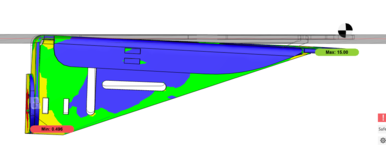

Got a small production run to do and have no experience with box brakes.
090 aluminum
this is the end state of the part.
The long bend there has a total of 4" of material to bend. I can adjust the slot dimensions a bit if needed.
looking at units like:
They gona laugh at this kinda thickness?

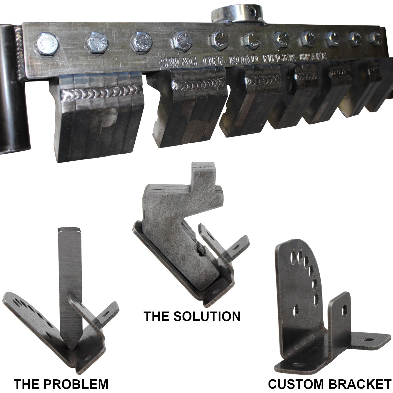

The slots you have at the bend will minimize the effective width of the material to be bent, but that's almost 11 gauge material.
If you have access to a hydraulic press, I might recommend something like the SWAG finger brake kit for that kind of money.
Alternatively, you may be able to get away with something like a vise mounted finger brake. They make them in 4", 6" and 8" depending on how big your part is (and how big your vise is).

Pre-made press brake attachments are available too.
You could use that with a inexpensive manual hydraulic press - but you did say "production run" so I'm guessing speed is a factor. A manual hydraulic press would be SLOW.
I can see both why you would want to use a brake instead and why you'd be concerned about it's ability to handle material that thick. They're not made for that type of bending... but the slots remove a lot of material and I'm guessing this part isn't that big? I think it seems plausible.
If you have a good vise, like GeoBruin's suggestion of a vise-mounted finger brake. They're not as robust as using a press, but that would be faster (and cheaper).

You might want to center the bending slot on the short tab so it doesn't pull to one side...

4" is factoring on the slots. so for the brake there is 4" of 090 to bend. the part length is about 9.5" overall but the brake wont see it that way.
looking to avoid welding on the part. using the bolt to control 2 planes for stiffness.

yes absolutely keeping the reliefs. keeps the bendable material to 4" overall. which I think I can reduce by another 25-30% if needed.
it doesnt need to be bang on accurate. I'm going to slot out one of the tab holes slightly to have an allowance from 88 to 92" on the main long bend.

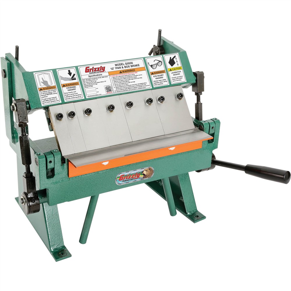

the 5052 would work just fine, but you need a real box and pan brake, not some Chinese toy. You also need one that can be supported with new fingers, as my suggestion is you need to grind the radius into the finger. Normally you get the radius by setting the top (clamp) back, but if you do that your bend will have a varying radius and a dent (stress riser). with a radius on the finger tip the leaf just wipes around making a constant radius. As you have no doubt figured out you can work with one finger, but what you REALLY need to do is make templates out of slightly thinner material so you can set up (backstop) each bend and then do 100 of the first, re-jig and test than 98 with second bend and to on to the end. There is no way you can meet the accuracy requirement to get you double tab holes to line up by marking and eyeballing the bends.

yup i planned to make 4 stations on a 4' brake if I end up with one that large. each station with a backstop jig.
I happened upon these. kinda curious how they would hold up. I can print my own.
also wondering if i dont just use a marketplace H frame, new cylinder and power pack to make a hydro brake with decent cycle times.

The vice mount tool can make nice bends, BUT: would be a proper ***** to set up backstop tooling and with any press brake you need punches with radius and angle to allow sufficient overbend to end up at 90 degrees. Easy with a box and pan (you make up adjustable travel stops for the leaf)
