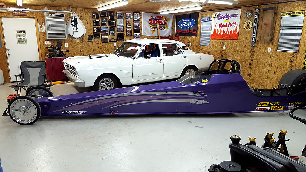

I didn't take this picture to show it but I ripped thin strips off 2x4's to cover the edge-to-edge seams where the OSB sheets met. I did this because I thought it looked neater and because I was re-using a BUNCH of OSB I got after wind blew down a block wall on my property and my homeowner's insurance put up a temporary wall with it.
The paint lines on my much-less-than-aesthetically-perfect OSB came out very good:
Just found this shot. Here you can see the strips a littel clearer:
