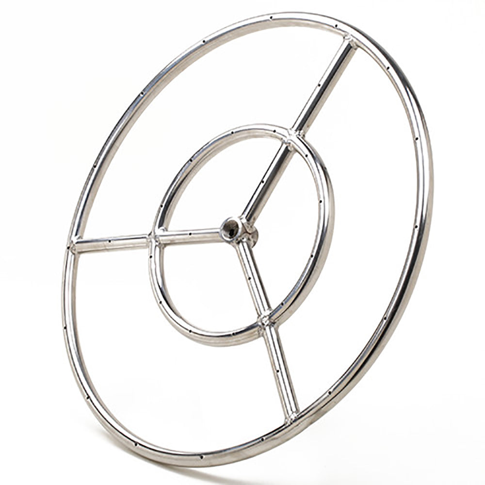

Hello folks,
Our new-to-us home has a round fire pit in the backyard. It is in great shape cosmetically, but it apparently hasn't been used for many years, and I want to resurrect it. It has a direct connection to our propane tank, so I would like to install a gas burner, but I've never owned or maintained one before, so I am at a loss as to where to start.
Since these pictures were taken I've uncapped the pipe and confirmed the operation of the shutoff valve, which is located on the outside of the pit, just below the feed. The interior diameter measures approximately 32". I've seen other fire pits in operation, and would prefer (if possible) to have the burner element hidden under a layer of rock. I want to start with a clean slate, so I'm looking for pointers on how to reconstruct the interior for safe and efficient operation.
Any observations and information is greatly appreciated - thanks!

Dig out all that dirt rock & inspect make sure the ****** ( pipe is sound/solid )
you can but a SS ring in various sizes - I think am 18 or 20 inch would be the ticket! A 24 might heat up the Rock Cap to much and w/ hot / cool might pop the rocks loose over time.
adjust the ring height with pipe fittings in relation to the top rock ring, secure the ring
I use 3/4 inch Lava rock as a filler you can get in in bags then buy Bigger Rocks piled up above the ring to create the effect. You can lay some sand below the 3/4 lava or some fire bricks 🧱 to help fill up or raise the ring up towards the top …. You don’t want it down low set Inside the pit. Makes for a boring fire 🔥. You want the flames up and out and dancing around all the big Lava rock
you can use glass beads instead of the lava rock

This is what I use and every 5-6 years you need a new ring, There pros / cons to install & mount with holes up / down …. Mounted holes up water gets inside but flame is better…
you can also stack 2 rings on top of each other 6-8 inches apart you want the flames up high.
so the rocks get hot from the flame and that creates the heat. You sit close - no embers spit / pop or fly out, just a nice calming heat
****** & cap were fused, but the ****** came off without too much difficulty. I replaced ****** & cap with new pieces.
I like your ideas, will look into that.
More great info, thanks!
