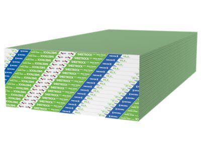

Howdy folks. I am getting ready to drywall my garage. It is an attached garage and there are two walls connecting to the inside of the home, one exterior wall and then of course the garage door. The garage is not heated or cooled.
I live in Louisiana where it gets very humid so that makes me think I should go with moisture/mold resistant drywall, but then I am being pulled in different directions telling me that code requires 5/8" fire rated drywall. I have been told two different things by two different reputable sources which has me pulling my hair out. The garage was lined with pegboard which I have ripped out. I'm insulating and adding drywall to be more aesthetically pleasing and to add value to the home for the chance that I do sell it. Anyone have any recommendations?

Fire rated X is not mutually exclusive with mold resistance. The X fire rating comes from 5/8" thickness, and fiberglass strands within the gypsum. The mold resistance is in how the surface is treated.

Despite the common and persistent myth, there is no IRC requirement for anything more than 1/2" drywall for attached garage walls. There may be a different local requirement, however, or you may feel more comfortable using type X, but 1/2" gypsum and a 20 minute door is all that is generally required. If the space above is habitable, then 5/8" Type X is required on the ceiling.

What you are up against is gas infiltration (carbon monoxide) and putting up a fire barrier between the garage and the living quarters.
The paper on the drywall is what supports mold growth, you need something that is treated to make the paper incapable of being food for the mold.
Sheetrock® Brand Mold Tough® Panels Firecode® X are mold and moisture resistant and are rated for garage/living space separation
