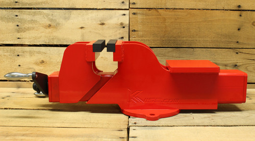

I'm Vise shopping and the 6.5" compact hardtail from Fireball is on my radar, seems like a decent price compared to Wilton and some other new offerings. That being said I'm thinking it might just be too much vise for my workbench (8'x2' made of hemlock and pictured below). Any thoughts? Should I just keep an eye for an old Wilton on marketplace?

To actually address the question: Yes, the Fireball is a damn nice vise.
The price is high, but fair for the quality you get. It's not US-made, but it is designed and sold by a small business in the US and an extremely robust design.
That said, it's a metal working vise and limited in what it can do. Personally, I prefer the versatility of a "multipurpose" vise for assorted mechanicking, and the chinese cheapo on my workbench has served me just fine for nearly three decades. For the money you're spending, I'd have a look at the major brands. You can get a DAMN nice Wilton MP vise that can do a lot more.
