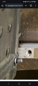

So these mount to blind hole? That could be your issue. Have you checked to make sure the plate mounting bolts seat deep enough into the base plate they can pull the top plates tight? Could be they aren’t threaded deep enough and or have debris in them. Also if you didn’t add just a lite coating of antiseize to them and with how many times you’ve assembled/ disassembled maybe galled and pulled some threads.

There is enough depth on the base plate to accommodate the bolts. The bolts engage the thread about 1/3" or so. I did notice when I went to go tighten down on the bolt that it would pull the plate tight up against the aluminum frame.
No, I did not add anti-seize to the bolts. I didn't think of it and unfortunately, there were no instructions when this package arrived. I had to go on their website and look at the pictures to see which rails went where.
You are absolutely right about having some threads that were pulled. I saw this this morning when I was taking it apart trying to figure everything out.
Look at post #38 and you'll see little pieces of aluminum In the thread holes.

Trying to pull a .69" solid plate flat via aluminum threads seems like a bad idea
Seems shimming is the best route, but for $1100 bucks I would be bummed to need to

Are the plates bowed or is it the tolerance stack up of the thickness from the pads to the top of the plate differing on each plate? From your video it seems it’s the tolerance stack up.
From Cam’s comment above, it looks like the bolts go through the plates into the aluminum. The holes in the aluminum appear to have some depth below the threads. I don't know the bolt size but make sure you have 1D engagement.
Usually the bolt will strip before the nut, even with a weaker nut because the od of the nut helps with the shear strength of the threads. How tight did you tighten the bolts to tear some of the threads?
Asking all these questions to offer some help since i feel for you spending that much and being disappointed.

When I put my flat edge across each individual plate, it looks good. But my flat edge is not anything special.
The bolts go into a bushing, which takes up the entire hole in the plate to keep it from moving around. It Then screws into the aluminum stock. There is no nut on the backside of the bolts that screw through the plate.
I just snugged the bolts down and then gave it just a tad bit extra when I was putting everything together. There were no directions in the box at all. But like another member suggested that me taking off the plates 30 to 40 times more than likely screwed up the threads.
I don’t think I am able to bend that plate with those bolts. I believe more than likely the aluminum stock is pulling upward the more I tighten it. I can see that as I was put in the bolts into the plate there were still a significant edge between the two plates, but when I went to tighten up the bolts, the plates did level out.

I don't get what stripped, isn't there a cam/bolt that drops in the hole?
Jswain
Apr 26, 2013
2,467
Calgary, AB
It appears that it threads into a blind hole in the aluminum
Looks like a large chunk of aluminum on this fastener? Is this the problem hole?
Curious if you were running the fasteners in with a power tool? The threads look pretty damn raw on all those bolts
