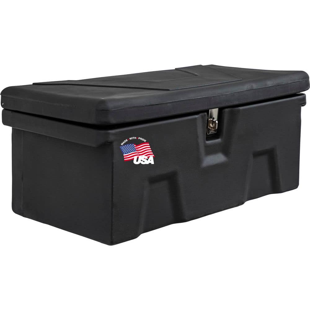

Thanks guys. I will move my extinguishers today. I have them near the welding bench thinking that would be the most likely fire location. BTW 5-6 years ago I happened on a free plastic tool/storage box like this
It is a perfect size for two 5 gal gas cans. There is a 3'x4' deck out side of the man door at the back of the garage so my mower gas is in that. Works great.
