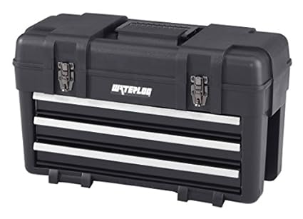

I want a portable case, and I found this USA-made 3-drawer box:
https://www.amazon.com/gp/product/B008DP7VBK/?tag=atomicindus08-20

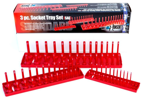

Good, yeah the blow molded cases are over rated. You can put your wrenches in wrench holders and put the sockets on socket rails or trays and then set the trays in the top part of the box.

I've got some wrench rings in the cart, and the sockets come on plastic holders that I figure will last a little while. I can always buy socket rails or cut some foam inserts to hold everything in place.
I figure the 1/4" and 3/8" will fit in one drawer, the 1/2" stuff in another, wrenches in the 3rd, and the top will be for overflow from my other box :)

Box, USA-made, polypropylene case with steel drawers.
