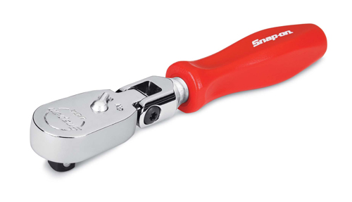

The 3/8" drive flex stubby with the hard handle.
FHFDK80, a great little 3/8 and comfortable too! I have been considering the FHFLD80 but I’m still holding out for a hard handle 3/8 roto to come back. I love my 1/4 hard handle roto even more than the flex heads.
However, I’m really liking the SK LP90 I got last year from Epstein’s, minimal back drag, 90T, very low profile head, really an awesome ratchet. Not as comfortable as a snap on hard handle, but not bad either.
