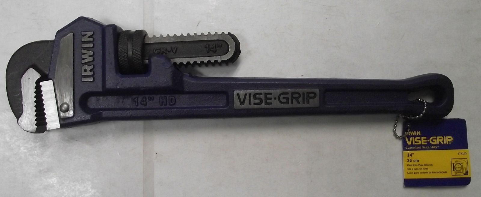

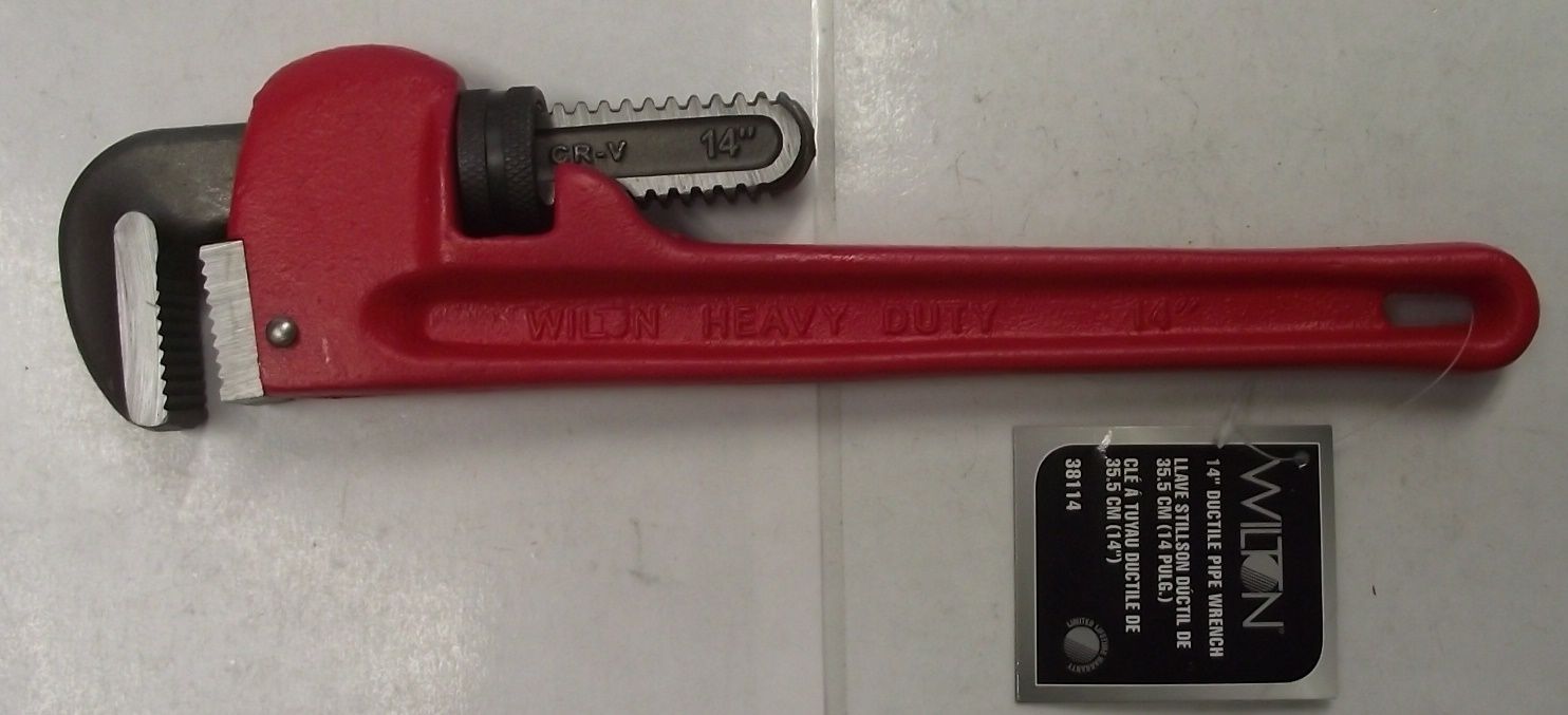

So, as a homeowner, this will be my first time pipe wrench buy. I've heard 14" would be the standard size for me. Aluminum is nice, but not necessary for something I may use once every few years. I just want to have one on hand if ever needed.
Cripes Distributing seems to be a good place to get tools at a good discount.
What do people think of the Armstrong, Wilton, or Irwin (see links). I had heard Armstrong was the same company that makes Snap-On?
I know Wilton makes good vices, but I don't think they make any other type of tool anymore?
Also, there is an interesting Superior brand one with what they call Quick Grip. Even though it's sort of a "gimmick" that my guess is a pro wouldn't use, perhaps for a homeowner like me it actually might be an advantage? What do you think? It's opening is only 1 1/2" vs. 2+" for all the others. Does that matter?

Of the four you listed, I'd go for the Wilton or the Irwin.
